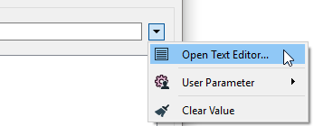

Defining Special CharactersYou can define special characters through the Text Editors. Click Open Text Editor from the parameter menu:
Text Editor Enter characters using the shortcuts from the table above. Note: To see tab characters, click the Options menu on the bottom left and select Show Spaces/Tabs. |
