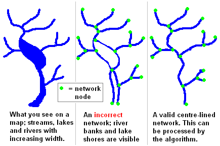

This recursive algorithm processes vector river networks for Strahler stream order values. The algorithm requires the vector network to be topologically correct to successfully process. The network must be a center-lined network where each arc (sometimes referred to as an edge) must be joined at their node (sometimes referred to as a junction). No left and right banks or lake side shores should be present.
Example
The image below demonstrates a map representation of a river network, an invalid network where lake and river bank sides have been digitally captured and a valid, topologically correct, center-lined river network which the algorithm can process.
If the network is "broken" (arcs not connecting) then the output will be incorrect. The algorithm would treat the disconnected catchment as a separate river system, so it is important to check the connectivity of the river network before attempting to compute Strahler order values.
