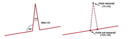

The transformer looks at every pair of line segments made up of three consecutive distinct points. If the angle (in degrees) between two line segments is less than or equal to the specified maximum angle, then the middle point is a spike and is removed.

If the Remove Spikes Iteratively parameter is set to No, the Removed features will have the following details about the spike added as attributes: _spike_angle, _spike_length1, and _spike_length2.
