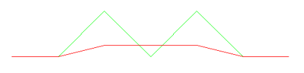

In this example, three bends are combined into one:

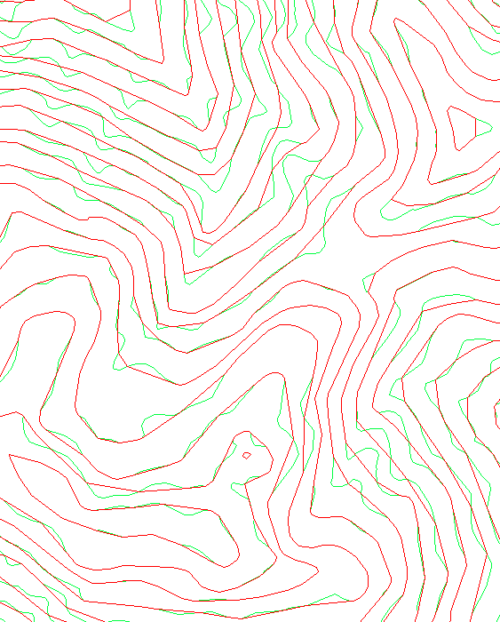

This example illustrates the generalization process on a set of contours:

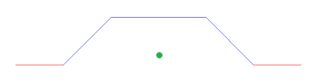

In this diagram, the blue bend cannot be generalized as it would violate the “Sidedness” constraint:
