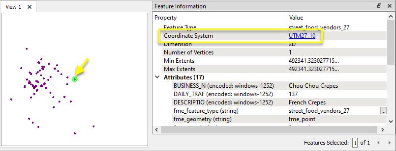

In this example, we have a shapefile of food cart vendors, with a UTM Zone 10 NAD27 coordinate system. We want to reproject this to NAD83, using PROJ.
The features are routed into a PROJReprojector.

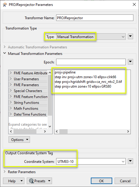

In the parameters dialog, Transformation Type is set to Manual Transformation.
The required PROJ pipeline string is entered, which references both the source and destination coordinate system definitions and the desired grid shift file.
The Output Coordinate System Tag is set to UTM83-10, ensuring that FME can correctly identify the PROJ output.

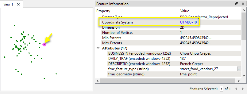

The output features have been reprojected using the PROJ library, and FME can identify them as UTM83-10.

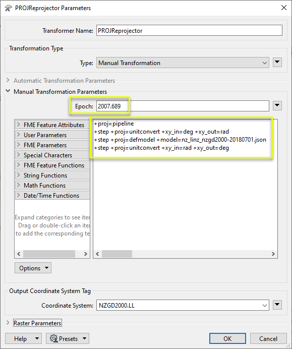

This example shows the PROJReprojector parameters configured to use an epoch with a PROJ pipeline.
Note that the desired deformation model is referenced in the pipeline string.
Epochs may also be provided via an attribute value or user parameter.

Epoch |
Used for spatiotemporal transformations. A decimal year that represents the time dimension to be used in the transformation pipeline. |
