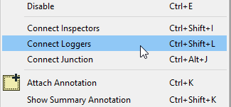

  • To quickly attach Logger transformers: right-click on one or more selected reader feature types and choose Connect Loggers.
