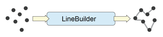

LineBuilder
Connects input point or line features in the order they enter, forming linear or polygonal features.
The output features will contain a merged set of attributes from all the features that were connected together, where the value for an attribute in the resulting feature comes from the first feature that had an attribute with that name that was part of the resulting feature.
For some datasets, it may be necessary to use a Sorter to order the data correctly before it enters this transformer.
