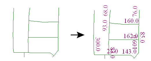

Interpolates labels along a linear or polygonal feature. Labels are placed at a regular perpendicular distance from the closest point on the line at some interval, and are given a rotation perpendicular to the line.
Example
