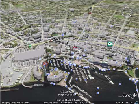

These transformer parameters are configured for a LookAt view type.
This is the resulting view of the selected area.
