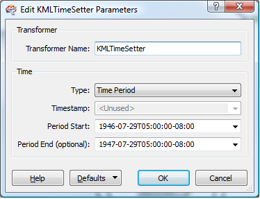

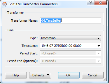

Type |
This parameter determines the type of KML time primitive that will be created. Possible options include Timestamp and Time Period. |
Timestamp |
This parameter specifies the value of the timestamp if the time type is Timestamp. The value can either be in the FME DateTime format, or the XML Schema time format. |
Period Start |
This parameter specifies the beginning of the time period if TimePeriod is the selected time type. The value can either be in the FME DateTime format, or the XML Schema time format. |
Period End |
This parameter specifies the optional end of the time period if TimePeriod is the selected time type. The value can either be in the FME DateTime format, or the XML Schema time format. |
