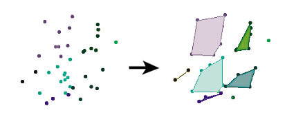

HullReplacer
Replaces the geometry of the feature with a polygon representing its hull.
