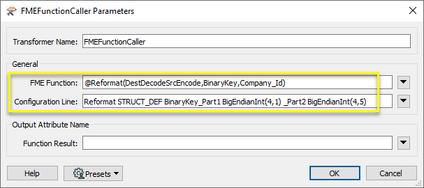

The @Reformat function requires a configuration line. To employ it within a workspace, the function would be called like this:
The configuration line which defines the "BinaryKey" binary structure is specified in the Configuration Line parameter.

FME Function |
Specifies the FME function (@FunctionName) to be called, as well as any parameters it can take. |
| Configuration Line | Optional: Can be specified if the underlying FME function requires it. |
| Result Attribute | (Optional) Name the attribute to contain the value returned by the FME function. |
