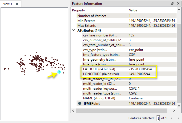

In this example, we have a dataset of world cities. The features have decimal degree coordinates as attributes. We want to convert those values to DMS.

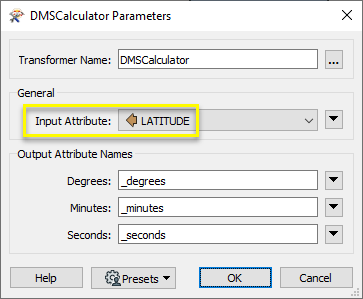

In the parameters dialog, Input Attribute is set to LATITUDE. Attribute names for the converted values - degrees, minutes, and seconds - are left with their defaults.

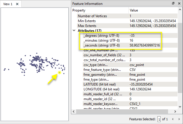

The output features have three new attributes, containing the converted values.
