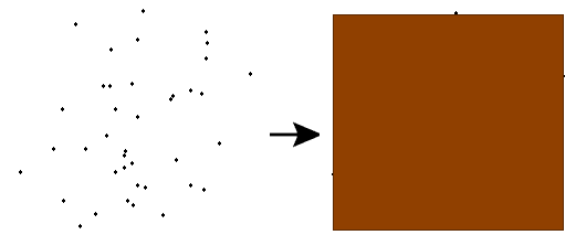

BoundingBoxAccumulator
Takes a set of point, linear, polygonal, and/or aggregate features, and creates a two-dimensional bounding box, which contains all features. The bounding box is defined as the minimum enclosing rectangle for all input features. The minimum rectangle is such that all sides of the rectangle are parallel to the x axis and the y axis. If an output bounding box has zero area, it will become a line or a point.
The input features may be partitioned into groups based on attribute values using the Group By parameter, and one bounding box feature is output for each group. If the Group By parameter is not specified, then all input features will be processed together and a single bounding box will be output.
