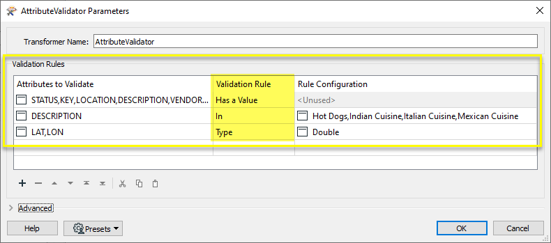

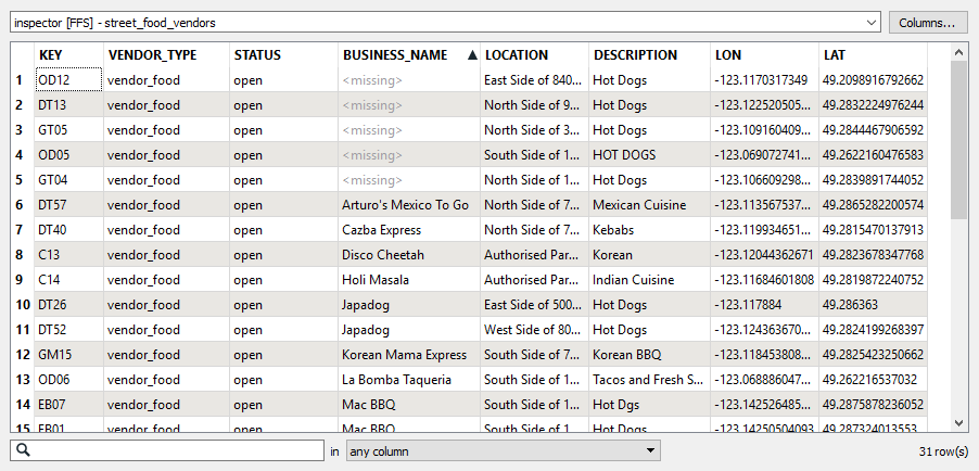

In this example, we have a spreadsheet of food cart vendors to test for data quality.
The features are routed into an AttributeValidator.
In the parameters dialog, we construct three tests to perform:
- Has a Value: All attributes are tested for the existence of any value, which will identify any missing data.
- In: The DESCRIPTION attribute is tested to see if its values are in a list of valid options. The list is typed in, with items separated by commas. Items that fail this test may have the wrong information, or data entry errors such as the wrong case or spelling.
- Type: The LAT and LON attributes are tested to see if they contain floating-point numbers. As these contain the location of the vendors, items that fail this test may have invalid coordinates.

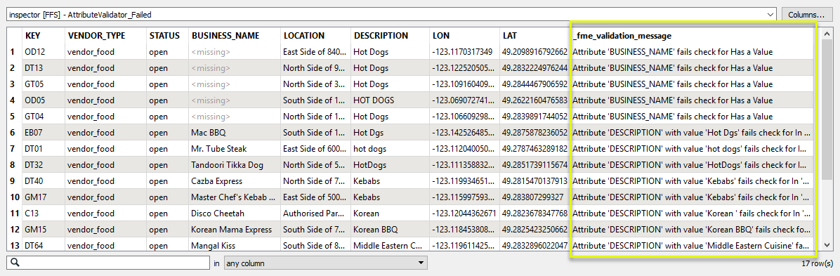

Features that fail any of the tests are output via the Failed port. A new attribute - _fme_validation_message - has been added, and contains details of the first test failed for each feature. Note that the tests are applied in the order they appear in the Validation Rule table.

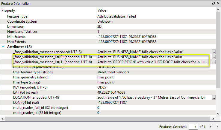

A new list attribute has also been added (which is not visible in the Table view) - _fme_validation_message_list{}. All tests failed are added to the list attribute.
Note that this feature has failed two tests - the BUSINESS_NAME does not have a value, and the DESCRIPTION has failed because the value HOT DOGS does not match the list item Hot Dogs (the case is wrong).
