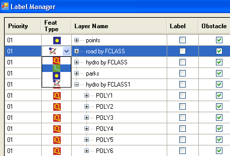

1.1. Label Manager Main Screen
Bring up the Label Manager dialog by clicking on the Label Manager icon in the
GeoLabel toolbar

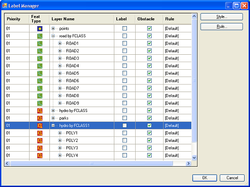

or selecting the GeoLabel →Label Manager menu item. You should see a dialog showing a list of layers that are in the Legend for the currently open map window, similar to the one shown below.
The Label Manager has the following columns (from left to right):

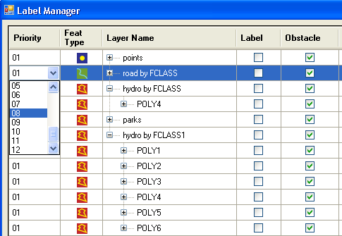

Priority. Feature layers can be assigned label-placement priorities, 1 being the highest and 12 being the lowest. Values for a layer can be changed by clicking on the value shown in the Priority column and selecting a different value from the pull-down menu.
Feature type. Small icons indicate the type for each feature layer:
indicates area-feature layers,
point-feature layers,
line-feature layers and
denotes layers with mixed feature types.
In case of mixed feature-type layers, the type to be labeled can be selected by a pull-down menu after clicking on the feature type icon as shown in the figure below. Either the line, point, or area icon must be selected; if the mixed feature-type icon is selected, then labeling CANNOT be turned on and labeling rules cannot be specified. In this case, the features of the layer can only act as obstacles.
Label. When this checkbox is checked for a feature layer, labeling will be performed for that layer. If unchecked, labels will not be placed for the layer.
Obstacle. When this checkbox is checked for a feature layer, its features will be treated as obstacles for the labels to be placed. If unchecked, the features will be invisible for label placement and thus labels will be allowed to cross those features.
Rule. Indicates the name of the currently active text placement rule. Can be changed by the user. A previously defined rule can also be selected from a pull-down menu by clicking in the Rule column of that particular row (the list will also include previously created shared rules – see section on Shared Rules). To read more on rules, click here.

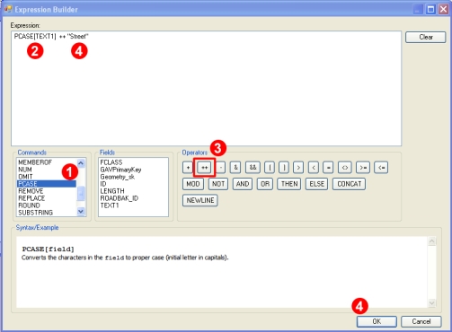

Data fields often contain only the name of the feature, and even that with lowercase. For example, the text field for a line feature (street) may only contain “wolfgang amadeus mozart”. On the map, however, it needs to appear as “Wolfgang Amadeus Mozart Street” with all initial letters in capitals. Label Manager’s expression builder helps carry out this conversion. The command PCASE converts the characters in the field (in this case TEXT1) to all initial capitals, and then we need to apply the ++ operator to concatenate “Street” at the end of TEXT1 with an intervening space.
Open the Expression Builder by clicking the Style and then the Expression buttons in the Label Rule Manager. In the command menu of the Expression Builder, double click on the PCASE command (Step 1); a dialog will appear. In that dialog select the attribute on which the expression should be executed (TEXT1), and build your expression (Step 2). This takes care of capitalizing initials.
After this click in the Expression box and type ‘++ “Street”’ or click the ++ operator in the Operator command group (Step 3) and type ‘”Street”’ after it. When finished, click OK (Step 4).

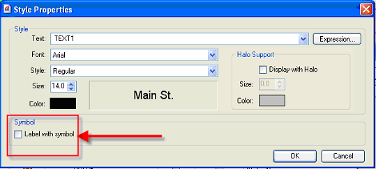

2.3. Labeling with symbols
Label Manager allows the user to place the label inside symbols. A typical application is route shield placement:
The dialog can be opened by clicking the Label with Symbol (1) checkbox in the Style Properties dialog:
After this the Style Properties dialog will expand:

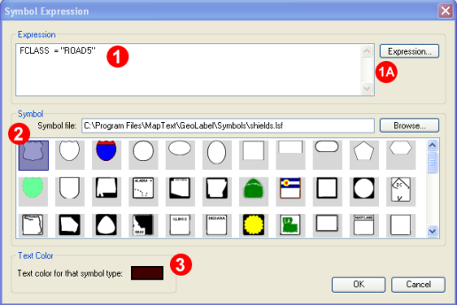

For the symbol to be defined by an expression, first click the Expression radio button (See 1 below) and then the “Add…” button (2):
After clicking the Add button, the following window will pop up. If you are familiar with expressions, type it directly into the Expression field (see 1 in the image below). Alternatively, you can click on the Expression button (1A) and use the Expression builder to construct your expression.
The following scenario is illustrated in the example below: a line feature layer called “road” contains several types of roads (streets, county roads, highways). The type identifier is contained in the data field FCLASS. We want to label the highways within that feature layer with a highway shield of our choice (2). The highways are identified by ROAD5 in the FCLASS data field. The appropriate expression is FCLASS = “ROAD5”. Then select the symbol you want to use (Step 2) and the text color (Step 3), and click OK.
Users can specify the size of the symbol on the bottom of the Style Properties dialog (1). The options are: fixed size or scale to text. When fixed size is selected and specified in points, the symbol will fit into a square with sides equal to the selected value. If the text fits into the symbol, it is placed with the specified font size; else the text size is shrunk to fit within the symbol.
When “scale to text” is selected, the size of the symbol will vary and scale with the text size.
When the window is closed and labeling is performed (to be explained later), all the features of ROAD5 type will be labeled with the specified symbol:

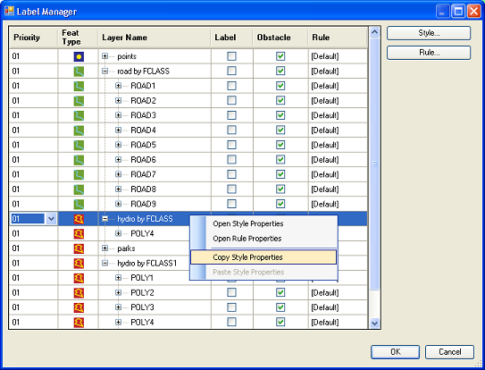

2.4. Mass configuration
Some datasets may contain tens or hundreds of layers. It is easier in such a case to copy and paste labeling style configuration than to define each one individually. For this a user has a copy context menu option available when right-clicking on a layer.
Once you copy a desired layer’s style, you can paste it over any selection of layers. Just Shift (or Ctrl) select multiple layers, right click and choose paste.

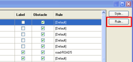

To set up rules select a feature layer in the Label Rule Manager and click the Rule button:

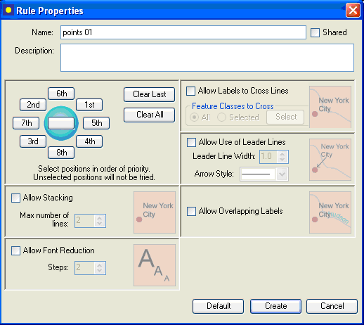

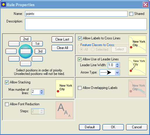

3.1. Labeling rules for POINT features
The point-feature placement rules can be set by selecting point-feature type layer(s) and clicking on the Rule button in the main screen of Label Manager. This will bring up the dialog shown below.
Users can either select the Default rules, or define rules for themselves and click the Create button.
The Rule Properties dialog offers the following options:
1. Selecting the positions around the point feature: the numbers 1st, 2nd, 3rd, etc. indicate the preferred positions where the text should be placed around the point feature located in the center. For example, in the above screen, 1st means that the text will first be positioned north-east of the point feature; if it is not successful, it will be positioned north-west of the feature (see position of “2nd”), and so on.
To define your own placement positions, click on Clear All, and select one-by-one your preferred text positions starting with the most preferred:
2. Allow Stacking: stacking means that feature names may be broken into a number of lines if necessary. The maximum number of lines can be specified by the user.
3. Allow font reduction: if this option is allowed and the label cannot be placed with the specified font size, then the font size will be reduced and labeling tried again. One step equals 0.5 points reduction and the user can set the maximum number of steps.
4. Allow labels to cross lines: if this option is allowed, labels may cross line features. You can allow all line and area features to be crossed or select the feature classes whose line and/or area features may be crossed.

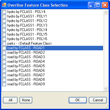

If you click the Select button, a dialog like the following will be presented, allowing you select the feature classes that may be crossed:
5. Allow leader lines: if this option is allowed, leader lines will be used for those point features that cannot be labeled otherwise. The arrow style can be defined by the user.
6. Allow overlapping labels: if this option is allowed, labels will be forced and may overlap with other labels.
The placement settings in the above dialog represent a sample. You may change those settings according to your requirements. After modifying the placement rules, click on Create – this will create the new rule. On subsequent modifications, the changes are made to a specific rule already defined. In the dialog, the Create button will now be replaced by an OK button. Click OK to apply these new settings to your label placement rules for the selected POINT feature layer.

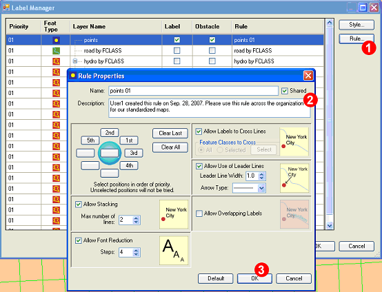

4.1. Sharing rules
The example below illustrates how to set up a shared rule for point feature label placement. After clicking on the Rule button for a point layer (1), click the Shared checkbox (2) and give an optional description of the rule. Then define the rule using the GUI options and click OK (3). Note: When the rule is defined for the first time for a layer, the button Create will appear instead of OK.
After this the name of the rule in the Rule column of the Label Manager will appear as points 01 (shared).
