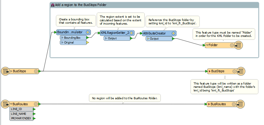

  1. When the template opens in FME Workbench, it will already contain input data and transformers (if applicable), along with explanatory annotations.
  2. Click File > Save to save the template as a workspace on your computer. FME saves the template on your local drive. Additionally, FME creates a folder of the same name, in the same location, that contains any associated input data.
