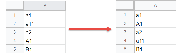

To sort table data, click on the header of the desired sort column. The last column header that is clicked becomes the primary sort column, the second-to-last becomes the secondary sort column, and the third-to-last becomes the tertiary sort column. You can sort on a maximum of three columns. Click a column header again to change the sort order from ascending to descending. Right click on a column header to specify a sort order or to specify that a column be sorted on either its alphabetical or numeric properties. To clear all sorting, right click on any column header and select Clear All Sorting.
Note: Unless Sort Alphabetical or Sort Numerical is explicitly specified, sorting is Natural. That is, FME Data Inspector sorts according to the values in the column, rather than the column data type. The following example shows how a column containing a mix of letters and numbers is sorted in ascending order (Sort Natural Ascending):
