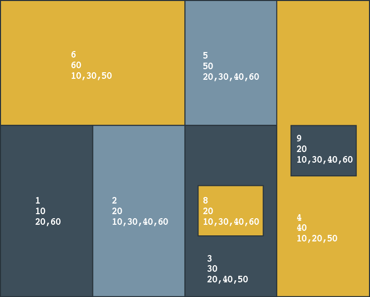

Example
In the example below, there are unique feature counts and then IDs.
If aggregates are not important, only 3 colors are required:
| Feature | Adjacent to Areas |
| 2,20 | 1, 3, 6 |
| 8,20 | 3 |
| 9,20 | 4 |

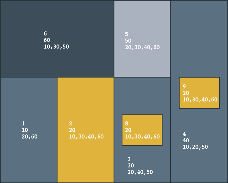

If, however, ID 2,20 is treated as an aggregate, then 4 colors are required and the pre-existing ID attributes must be supplied.
| 20 | 10, 30, 40, 60 |
| Feature | Not Adjacent to Area |
| 20 | 50 |
