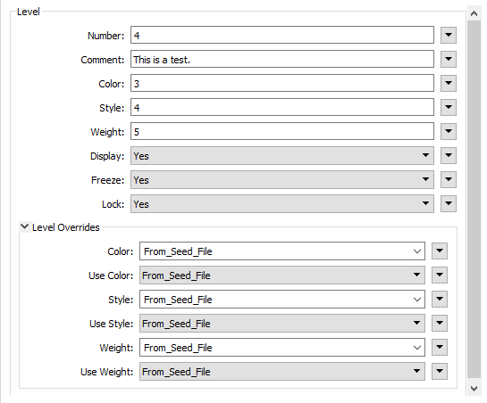

Level
| Feature Type Parameter | Description | Corresponding IGDS Attribute |
| Color
 | The color of the destination level. Used for elements that set their color by level. | igds_level_color
| Comment | The comment of the destination level. | igds_level_comment |
| Display
 | The display property of the level to be created, which affects the display or visibility of the elements on it. | igds_level_display |
| Freeze
 | The freeze property of the level to be created, which affects the display or visibility of the elements on it, including nested or complex elements which may have their own level information. | igds_level_freeze |
| Lock | The lock property of the level to be created, which affects the ability to manipulate the elements on it. | igds_level_lock |
| Number | The level number corresponding to the feature type. Note that feature type is treated as level name. | igds_level |
| Style
 | The style of the destination level. Used for elements that set their style by level. | igds_level_style
| Level Weight
 | The weight of the destination level. Used for elements that set their weight by level. | igds_level_weight |
Level Overrides
| FME Workbench Feature Type Parameter | Description | Corresponding IGDS Attribute |
| Color
 | The color of the additional symbology, called override symbology, for the destination level. This is set in combination with Use Color, which flags this override for use. If set to From_Seed_File, the override color is taken from the value for level override color in the seed file. If this value is not found in the seed file, the default seed file level is used. | igds_level_override_color
| Level Weight
 | The weight of the additional symbology, called override symbology, for the destination level. This is set in combination with Use Level Weight, which flags this override for use. If set to From_Seed_File, the override weight is taken from the value for level override weight in the seed file. If this value is not found in the seed file, the default seed file level is used. | igds_level_override_weight
| Style | The style of the additional symbology, called override symbology, for the destination level. This is set in combination with Use Style, which flags this override for use. If set to From_Seed_File, the override style is taken from the value for level override style in the seed file. If this value is not found in the seed file, the default seed file level is used. | igds_level_override_style
| Use Color | The flag that indicates that override color should be used as a part of level override symbology. This is set in combination with the Color parameter, which specifies the override color value. If set to From_Seed_File, the override color flag is taken from the default level in the seed file. | igds_use level_override_color |
| Use Style
 | The flag which indicates that override style should be used as a part of level override symbology. This is set in combination with the Style parameter, which specifies the override style value. If set to From_Seed_File, the override style flag will be taken from the default level in the seed file. | igds_use level_override_style
| Use Level Weight | The flag which indicates that override weight should be used as a part of level override symbology. This is set in combination with the Level Weight parameter, which specifies the override weight value. If set to From_Seed_File, the override level weight flag is taken from the default level in the seed file. | igds_use level_override_weight |

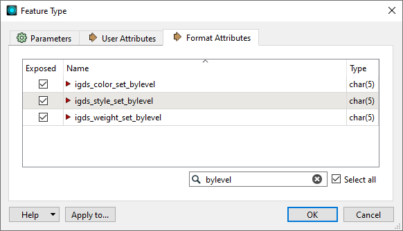

Note that if any feature being written to this level is intended to have symbology by_level, then the attributes igds_color_set_bylevel, igds_style_set_bylevel, and igds_weight_set_bylevel must be exposed in the Format Attributes tab:
The level override values on the Feature Type are separate from the feature attributes. They form an additional symbology for a written level, which is used with the Level symbology setting, taken from the seed file.
