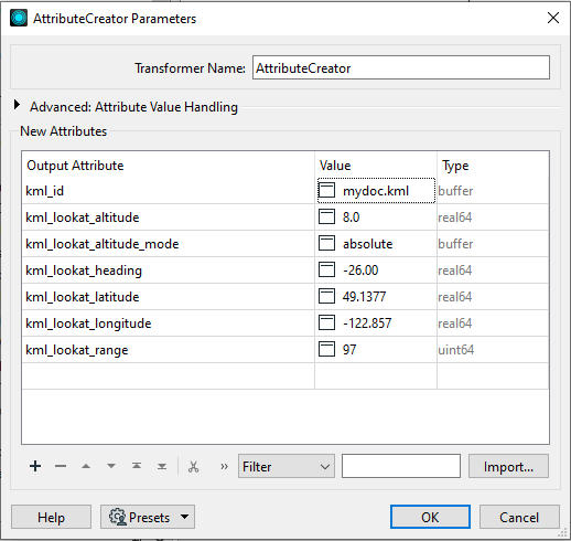

- Create the following attributes in the AttributeCreator:
Attribute |
Value |
AttributeCreator Example |
kml_id |
The value must match the filename of the destination dataset (that is, if you are writing to mydoc.kml, the id should be mydoc.kml) . If the kml_id does not match, a second document will be created. |
kml_lookat_longitude (required) |
Maps to the <longitude> element of <LookAt> |
kml_lookat_latitude (required) |
Maps to the <latitude> element of <LookAt> |
kml_lookat_altitude |
Maps to the <altitude> element of <LookAt> |
kml_lookat_altitude_mode |
maps to the <altitudeMode> element of <LookAt> |
kml_lookat_heading |
Maps to the <heading> element of <LookAt> |
kml_lookat_tilt |
Maps to the <tilt> element of <LookAt> |
kml_lookat_range |
Maps to the <range> element of <LookAt> |

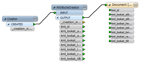

The finished workspace should look like this example:
