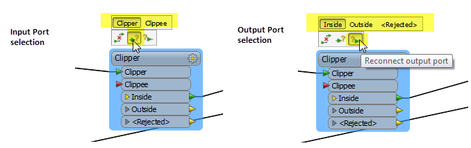

Upon auto-connecting a transformer, a connection toolbar appears above the transformer
. If you wish to remove connections while keeping the transformer on the canvas, click Undo Automatic Connection
. To undo, add, or change input port connections, click Reconnect input port
. To undo, add, or change output port connections, click Reconnect output port
. The connection toolbar disappears when focus shifts away from the transformer.

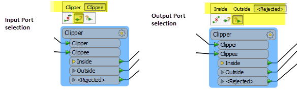

Inserting a Transformer: Separate Connections
You can connect a single transformer into multiple input ports that require separate connections. A Clipper transformer, for example, has multiple input ports that require separate connections.
The first connection is easy. When you place the transformer over the connection, the connection toolbar allows you to set specific ports. Click the input and output buttons and then select the ports from the list of ports that appears above the button:

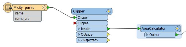

Dragging a transformer that is already inserted still causes a highlight point to appear, and connections to be highlighted. You can make a second insertion with the same transformer, but onto the additional link. Again, use the connection toolbar to set the ports:
