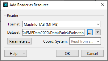

Select Readers > Add Reader as Resource or right-click Workspace Resources in the Navigator:
After you click OK, the log file will display the processing statistics associated with the selected dataset, and you will see a Translation SUCCESSFUL message, indicating that FME Workbench has successfully processed the dataset.

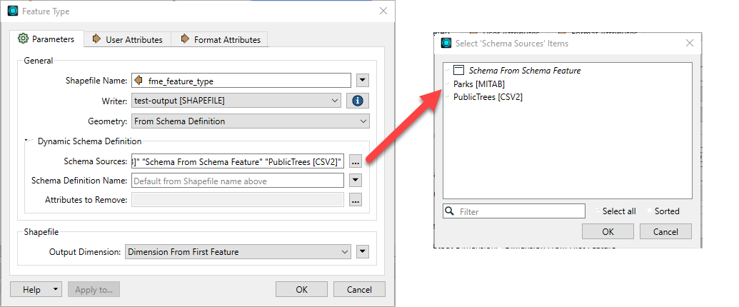

When you want to use the schema from a reader, open the Writer Feature Type dialog, and check the Dynamic Schema Definition box.
Schema Sources: Click the Browse button to select from a list of existing schema readers. Only the readers that you have selected will be used at runtime. If Schema from Schema feature is selected, the schema of the first feature to reach the writer is used. This option is useful if your workspace produces a user-defined feature that may not contain any actual data, but contains useful schema information. For more information, see Deriving Destination Schema from Schema Feature.
Schema Definition Name: Defines how elements in the schema definition of the feature type are named. By default, schema elements are named based on the feature type name, under General Parameters. Alternatively, you can name schema elements based on a specified attribute.
Attributes to Remove: This option allows you to remove attributes from the feature. Click the ellipsis (...) and enter the names of any attributes you do not want in the destination feature (for example, OBJECTID, SHAPE_Area, and any others).
