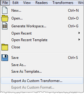

- Create a custom transformer. If it is an embedded custom transformer, export it as a linked custom transformer.

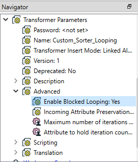

 - Open the linked custom transformer (.fmx file) in FME Workbench. In the Navigator, under Transformer Parameters > Advanced, set Enable Blocked Looping to Yes.

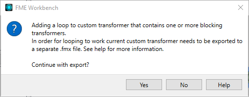

Alternatively, when you add a loop port to a custom transformer that contains a blocking transformer, FME prompts you to export the custom transformer, and displays the following message:

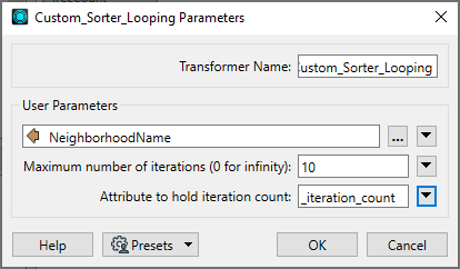

When "Blocked Looping" is enabled in a linked custom transformer, two additional parameters are exposed on the transformer: Maximum number of iterations and Attribute to hold iteration count:
These two parameters control how many times the loop is to be executed and help prevent infinite looping.
