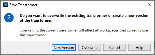

To create Version 2 of a custom transformer
- Open the custom transformer and make your desired changes
 - Select File > Save on the menu, or click the Save icon on the toolbar.
 - The following prompt displays:
 - Click New Version.
The custom transformer is now saved as Version 2.

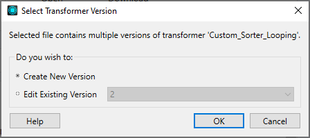

To create Version 3 or later of a custom transformer.
- Open the custom transformer.
 - Select Create New Version and click OK.
The custom transformer is saved and opens as the next version.
