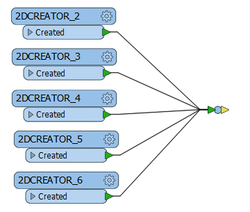

                                                Junctions are a useful tool for managing connections as you build and organize a workspace. For example, you have five Creator transformers that you want to join before you proceed with building the rest of the workspace. You can create a Junction in the workspace that brings them together.
Junctions are also useful as a starting point when Running and Inspecting Part of a Workspace.
To insert a Junction using quick add, start typing 'Junction' on a blank spot on the canvas, and select 'Junction' when it appears. Junctions look like this when you add them:
Connect the elements of your workspace to the Junction as you would normally.
