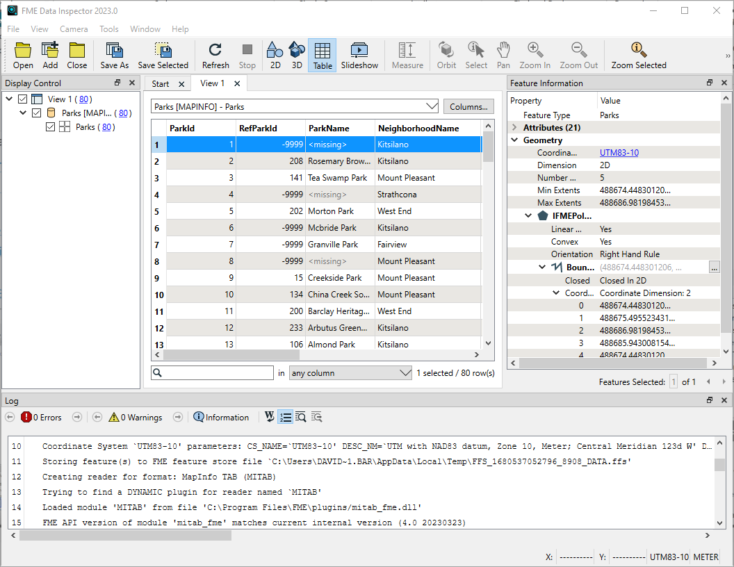

Viewing Data in Table Mode
                                                In addition to 2D or 3D view modes, you can view attribute data for features in table format. When either 2D or 3D view mode is active, the Table View appears outside of the View window, in another part of the interface (as long as it is selected in the View menu, under Windows). To replace the 2D or 3D data in the View Window with the Table View, click the Table View icon (
) on the toolbar, or press Ctrl+1 on your keyboard. The Table View appears directly in the View Window:
Alternatively, when not in Table View mode, you can drag and dock the Table View to another part of the interface, or as a separate window.
The Table View displays data for a selected feature type. To switch between feature types, for each dataset, use the Table drop-down selector above the table.
Alternatively, in the Display Control, double-click the feature type name, or right-click and select Show Table.
When you perform an initial switch between feature types, a series of tabs for each one that has been viewed appears above the table. These tabs make it easy to switch back and forth between the feature types you have viewed.
The data columns themselves can be moved by clicking and dragging on the column headers.
Table View displays only the first 2000 columns (attributes) of data.

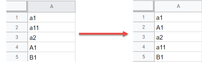

Sorting Table Data
To sort table data, click on the header of the desired sort column. The last column header that is clicked becomes the primary sort column, the second-to-last becomes the secondary sort column, and the third-to-last becomes the tertiary sort column. You can sort on a maximum of three columns. Click a column header again to change the sort order from ascending to descending. Right click on a column header to specify a sort order or to specify that a column be sorted on either its alphabetical or numeric properties. To clear all sorting, right click on any column header and select Clear All Sorting.
