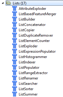

List transformers allow you to work with list attributes.
See the Lists category in the Transformer Gallery:
Convert List Elements into Regular Attributes
