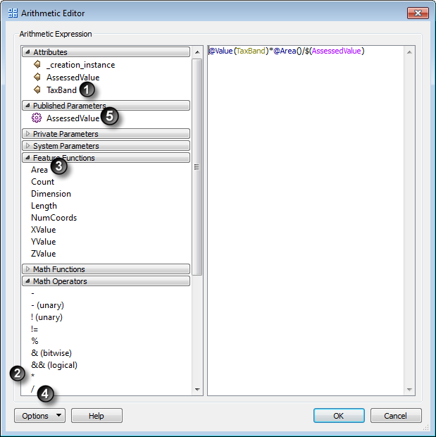

Similarly, in the AttributeCreator transformer, you could create an attribute such as a property’s Taxable Value using an expression such as (@Value(TaxBand) * @Area())/$(AssessedValue).
The numbers 1-5 show the order in which the elements were added to the editor:
Attributes
After the transformer is connected in the workspace, this section lists the available attributes. You can use attributes to supply a value for use within the arithmetic expression.
Published/Private Parameters
This is a list of the published/private parameters (if any) that are in the workspace. You can use published parameters to supply a user-defined value for use within the arithmetic expression.
FME Parameters
In some scenarios, FME Parameters may be useful in the workspace.
FME Feature Functions
These functions are capable of returning a numeric value, which is substituted into the arithmetic expression where defined.
For more information, see FME Feature Functions.
Math Functions/Math Operators
For more information, see Math Functions and Math Operators.
