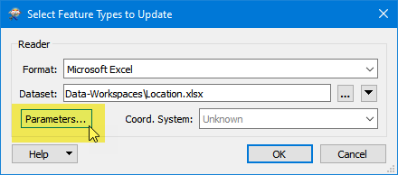

If Update Feature Types does not refresh the schema, open the Parameters dialog while in the Update dialog. This will trigger a new read of schema.

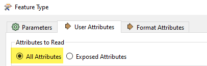

If a column has been renamed in such a way, the reader will still produce the old attribute name with null or missing data, and produce the new attribute name with the data. With individual feature types, it is possible to have the reader detect new attribute names by setting the Attributes to Read option in the User Attributes feature type dialog to All Attributes:
