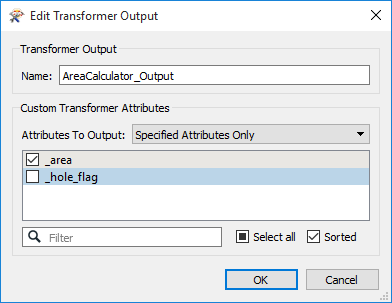

- Specify any attributes to output (output port): In the Attributes to Output field, you can specify which attributes to output:- Specified Attributes Only: The port outputs only the attributes whose checkboxes are selected. Any attributes that are not selected are removed and are not available to subsequent custom transformers, workspaces or feature types.
- All Attributes: The port outputs all of the attributes listed below the drop-down list.
 In this example, only the _area attribute is output:
