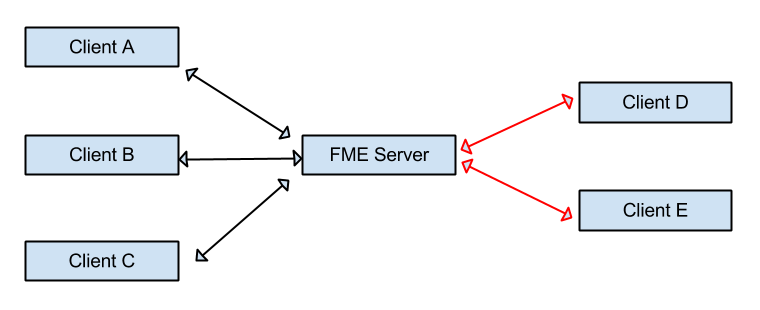

The "chat" protocol sends messages to all recipients with the same <sessionkey> value. In the above example, the bi-directional arrows in black indicate session key “black”, and the bi-directional arrows in red indicate session key “red”. Clients A, B and C can communicate with each other because they have the same chat session key. Clients D and E can communicate with each other because they have the same chat session key.
