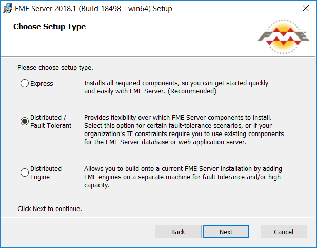

Choose Setup Type
Select the Distributed/Fault Tolerant install option.
