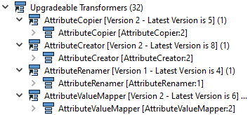

Transformers whose version is earlier than the latest version available appear in the Navigator, under Upgradeable Transformers. The current version, and the latest version available, both display:

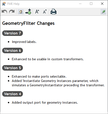

To view detailed information about how the transformer has changed between versions, right-click on the transformer name (as it appears directly under Upgradeable Transformers) and select Show Changes.

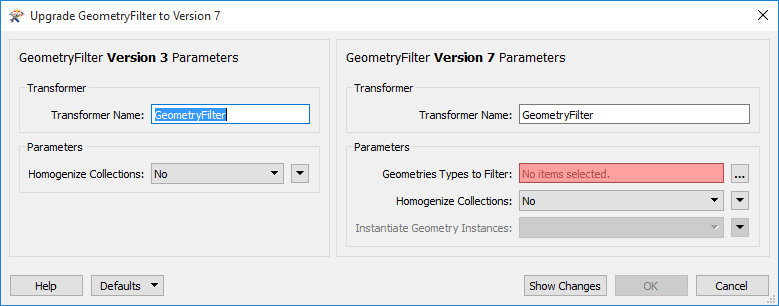

- Select Upgrade Transformer. An Upgrade window opens:
- Parameter Changes: If the selection of parameters has changed between versions, the current parameter settings display on the left of the Upgrade window, and the mapping of these settings to the upgraded parameter settings displays on the right. If any new or revised parameters require settings, they are highlighted in red. You cannot proceed with the upgrade until these missing parameters are resolved. To learn more about any new or revised parameters, click Help.
- Detailed Version Changes: Click Show Changes. The FME Help viewer displays detailed information about how the transformer has changed between versions.

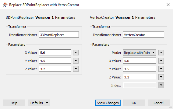

In some cases, a transformer from a previous version of FME Desktop may have been deprecated, either because it was renamed, its function was merged into an existing transformer, or a new transformer was created that merges the functions of multiple transformers. Deprecated transformers also appear in the Navigator under Upgradeable Transformers, but are distinguished by indicating the transformer it is 'Replaced by'. In this example, the 3DPointReplacer is replaced by the VertexCreator:
The process for upgrading from a deprecated transformer is similar to that of other transformers, except the upgrade is performed in a Replace window, rather than an Upgrade window. In the following example, the parameters of the deprecated transformer, which appear on the left, map to the corresponding parameters of the replacement transformer on the right.
