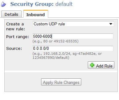

When specific ports are desired, the port should be made available and not blocked by firewall settings. In the following example, Amazon Web Services firewall security settings are configured for an instance to reserve ports 5000 - 6000 (incoming) for the UDP trigger:
