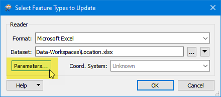

Selecting Update Feature Types doesn’t refresh schema
If Update Feature Types does not refresh the schema, open the Parameters dialog while in the Update dialog. This will trigger a new read of schema.
