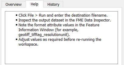

Help
List any special instructions here. Example:
You can also use this area to:
- List any requirements that must be met before using the workspace or template, such as where the source data resides or minimum FME version required. You should also list any dependencies (for example, if you need a third-party application or an extra-cost transformer).
- Record any legal information (for example, copyrights or data restrictions).

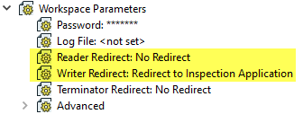

You can quickly reroute your output without having to add anything to your workspace. You might want to do this if you're having problems in your workspace, and want to examine features or information before writing to your original output file or folder.
Locate the Workspace Parameters in the Navigator pane. Double-click Reader Redirect or Writer Redirect:
- No Redirect: This is the same as keeping the <not set> default.
- Redirect to Inspection Application: View data in the default inspection application before writing to the output file or folder.
- Redirect to FFS File: This option is useful for debugging complex workspaces. The output is written to FME Feature Store files (FFS). The FFS files can then be viewed using the Inspector. Redirect to FFS can also be used to send database data to Safe Support. Since this option does not use the format writers configured in the workspace, it can be used to isolate problems that may be occurring in a specific FME format writer.
- Redirect from FFS file: Used for debugging complex workspaces. Output that has been created using Redirect to FFS file can be reloaded into the workspace using Redirect from FFS file.
- Disable Output: Instead of writing many features to a dataset, you might just want to see information or statistics gathered during processing. No features will be output.
After you run the workspace, the log displays a message as a reminder that you have redirected your source or destination.
