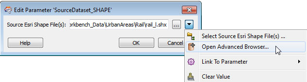

Double-click the dataset name in the Navigator and select Open Advanced Browser from the Edit Parameter menu:

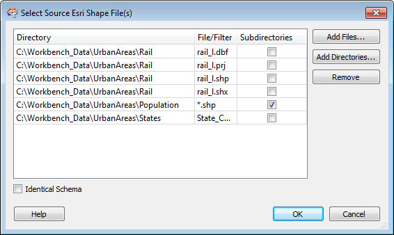

This opens the Select File dialog:
Subdirectories: If there are subdirectories below the initial dataset location, check the box to include them.
Add Files: Opens the file browser. You can select individual files, or Ctrl + click to select multiple files.
Add Directories: Opens the file browser so you can select entire directories to add to the reader. All files that are in the specified format in those directories will be included.
Identical Schema Check this box if you know that all the files have the same schema. This is a time-saving function: there will be no difference in the workspace results. If you know the files have the same schema, FME will not have to perform an initial scan of all the files to determine their schema. Instead, FME will take the first file as being representative of the data model.
