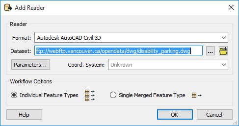

To add a reader using a URL instead of a file location:
  1. Open the Add Reader dialog.
  2. Select the Format.
  3. Type or paste the URL of a dataset into the Dataset field

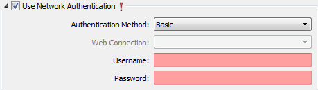

Note: In the Reader parameters dialog for most formats, the parameter Use Network Authentication is visible when the dataset is a URL.
