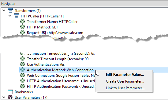

Many processes in FME Desktop require you to connect and authenticate to a web service in order to use them. For example, when you use an HTTPCaller transformer, you may need to authenticate to a web service, such as Google BigQuery. Similarly, if you want to connect to an FME Server, you must specify a set of connection parameters. Web connections provide a convenient and secure way to store and reuse these connection parameters. Each time you need to specify the same connection parameters, you can use the connection, rather than re-entering the parameters. If the connection parameters change, you can edit them in one place, rather than in each workspace that uses the connection.

You can use an existing web connection, or define a new one, in a Transformer Parameters, Add Reader, or Add Writer dialog, as well as in the Publish to FME Server wizard.
