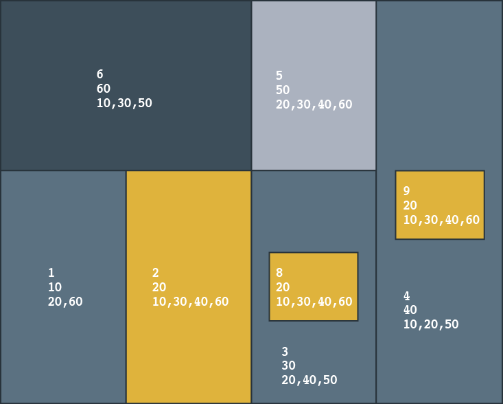

These parameters are used when the Color Scheme is set to Map Coloring.
When you provide a Pre-existing Area ID Attribute and Neighbor ID Attributes for each area, you can force the relationships to follow pre-existing mappings. For example, if your data contains aggregates and you know the area to which they belong, you can define that relationship using these parameters.
This option is especially useful when the input data contains aggregates and you want to "map" pre-existing IDs to define the relationships.
Note: If these parameters are not provided, adjacencies between areas are determined geometrically, and non-polygon geometries (including aggregates and ellipses) are removed.
Area IDs must be non-negative integers, and neighbor IDs are entered as a comma-separated list.
Example
In the example below, there are unique feature counts and then IDs.
If aggregates are not important, only 3 colors are required:
Feature | Adjacent to Areas |
2,20 | 1, 3, 6 |
8,20 | 3 |
9,20 | 4 |
If, however, ID 2,20 is treated as an aggregate, then 4 colors are required and the pre-existing ID attributes must be supplied.
20 | 10, 30, 40, 60 |
Feature | Not Adjacent to Area |
20 | 50 |
