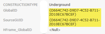

In some programs (for example, ArcGIS Pro), GlobalID and GUID attributes contain braces:
When set to Yes, this parameter removes the braces from the GlobalID and GUID attributes for compatibility with programs where these attributes do not contain braces.
The default is No.
