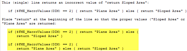

If you have multiple print or |
puts {Tcl2 error {my message}} See FME Factories and Functions help for the complete description of the |
