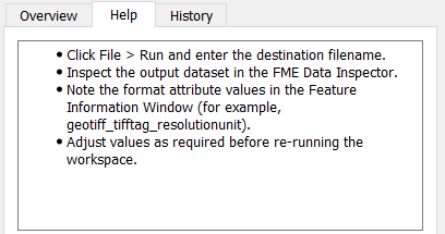

Help
List any special instructions here. Example:
You can also use this area to:
- List any requirements that must be met before using the workspace or template, such as where the source data resides or minimum FME version required. You should also list any dependencies (for example, if you need a third-party application or an extra-cost transformer).
- Record any legal information (for example, copyrights or data restrictions).
Use Markdown
When checked, some rich text features of the dialog are not available. This box must be checked if you want to upload to FME Hub.

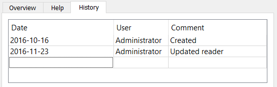

History
Record changes made to the workspace. This is especially good practice if you are sharing data or workspaces.
Example:
Last Save Date, Last Save Build
The History tab also displays the date and FME build on which the workspace was last saved.
