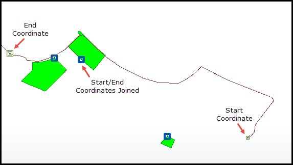

There are three types of markers:
- Square with center point: The starting coordinate of a geometry.
- Two squares with center point: The ending coordinate of a geometry.
- Thick square with center point: The starting and ending coordinates of a geometry that are joined together (that is, they are the same value).
In this example, the starting and ending coordinates that comprise parks and a bicycle path are marked:

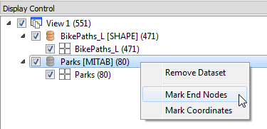

To view starting and ending coordinates, right-click on the view, dataset, or feature type in the Display Control, and select Mark End Nodes. To mark all start and end coordinates that display in the View, right-click on the view. To mark start and end coordinates of all features in a dataset, right-click on the dataset. To mark start and end coordinates of all features of a feature-type, right-click only on the feature type.
To remove all start and end coordinates, right-click at the level you want to remove, and unselect Mark End Nodes. If a view contains more than one dataset, or a dataset contains more than one feature type, you can specify Mark End Nodes > All or Mark End Nodes > None at the view or dataset level. At the view level, these options allow you to toggle from displaying start and end coordinates of a subset of datasets to displaying start and end coordinates of either all datasets, or no start/end coordinate at all. Similarly, at the dataset level, these options allow you to toggle from displaying start and end coordinates of a subset of feature types to displaying start and end coordinates of either all feature types, or none of the feature types.
