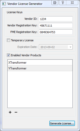

If an FME user wants to download and use the XTransformer, the user will contact the author by sending an email with his or her FME registration key. Upon receiving the user’s key, the author will run the LicenseGenerator tool provided by Safe Software and generate a license file for the user. The license file should be named the same as the one specified in the LicenseChecker in Step 2.
A license file may support licensing single or multiple products. If the author has more than one product (for example, custom transformers or workspaces), these product names can be included in one license file and validated by separate LicenseChecker transformers.
For example, if the author has another custom transformer called YTransformer that does some attribute manipulations, company ABC can use the LicenseGenerator tool to add both XTransformer and YTransformer to the same license file:
