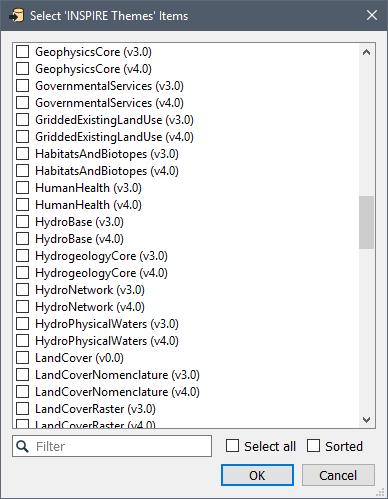

- by Themes(default): Enables the INSPIRE Themes parameter.
- by XSD: This option enables the Application Schema parameter, where you can specify a different INSPIRE schema (other than the built-in themes).
When reading schema features or importing feature type definitions into the INSPIRE writer, the INSPIRE reader dataset parameter may be left unset.
Browse a list of the available INSPIRE themes.
FME supports themes up to and including v4.0.
