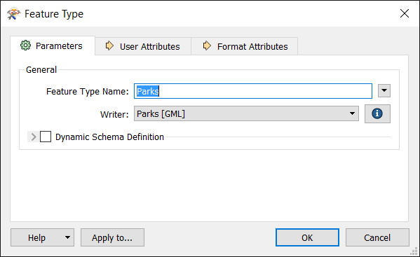

To display the Feature Type dialog, do one of the following:
- Click the gear icon on the feature type.
- Right-click on a feature type and select Properties from the menu.
- On the menu, select View > Windows > Parameter Editor. On the canvas, select the feature type.
Just like Writers, feature types have their own set of parameters that control how that feature type (layer/table) is being written. These parameters apply only to a single feature type, whereas a Writer parameter applies to all feature types. Writer Feature Type parameters provide a degree of individual control over writing different layers or tables.
You can rename the feature type by simply clicking in the Feature Type name field and typing a new name.

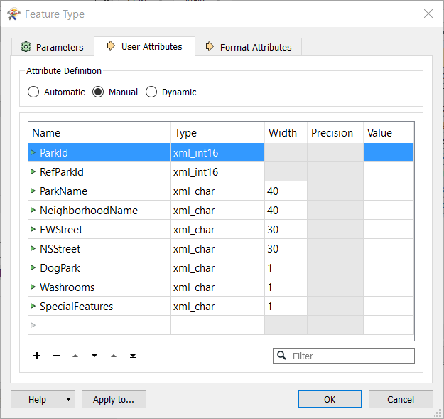

When Attribute Definition is Manual, the workspace author can manually enter attribute names, select the attribute type, and define cell width, formatting (where applicable), and values. This example shows three attributes that have been defined for an address table:
On the Workbench canvas, the feature type looks like this:
To assign a User Attribute value, you can enter a fixed (constant) value, set a conditional value, open an editor, or select User Parameters. This example shows three attributes that have been defined for an address table, and one attribute that has a defined value:

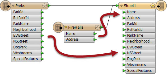

Because this operates automatically, if the Reader feature type is removed, and another one is connected, the list of attributes on the Writer feature type will be immediately updated to match. Or, if a second Reader feature type is connected, then the list of attributes updates to become a union of the two types:

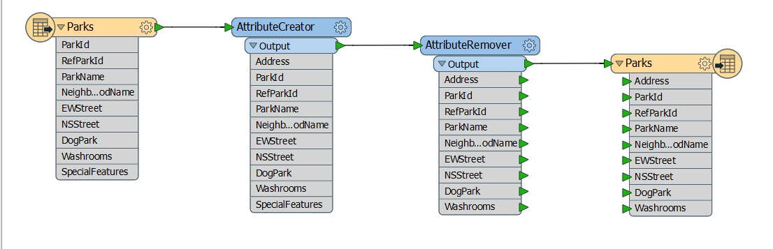

Likewise, when transformers that change the composition of attributes are connected to writer feature types, the list of attributes updates accordingly. Here, an AttributeCreator transformer adds attribute Address, and an AttributeRemover transformer removes attribute SpecialFeatures. The attribute list on the writer feature type automatically updates:
