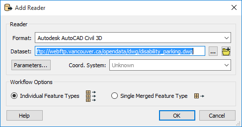

Another variation on a dataset location is the ability to read data from a URL.
Defining a URL dataset to be read is as simple as entering the URL into the Dataset field within any of FME’s dataset selection tools. After reading, the data will be downloaded and used just as if it were a normal dataset.
URL datasets can be read using either HTTP or FTP.
Note: FME cannot currently write data directly to a dataset defined by a URL. In this scenario, the data must be written out to the local file system, and then uploaded to the required location using a shutdown script or an HTTPFileUploader transformer.
To add a reader using a URL instead of a file location:
- Open the Add Reader dialog.
- Select the Format.
- Type or paste the URL of a dataset into the Dataset field
Note: In the Reader parameters dialog for most formats, the parameter Use Network Authentication is visible when the dataset is a URL.
- Click OK to add the reader to the workspace.
