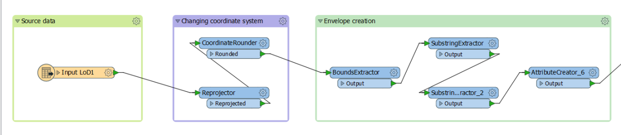

In this workspace (partially shown), bookmarks define where specific tasks are performed so they can be referenced more easily:
